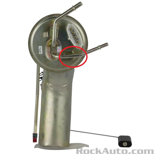

Ended up putting a pinhole in the return tube on the hanger assembly, about where the red circle in the pic is.
After putting everything back together I found this leak.
What happened is the quick connect would not disconnect. It looks like the weld at that bracket to the tube broke the line open when we were working on getting the quick connect fitting off. We tried to not break things but that connector would not budge. Eventually we got it off but everything inside of the connector stayed on the end of the line due to rust. We took a quick trip to the nearest JY, from my friend's place, which was You-Pull and Save in Pontiac. Got the quick connect flex lines with some length of stainless 5/16 on the end opposite the quick connect, for $15 total including yard entry fee. Got them from a mint-before-the-crash '97 LTC (front right fender headlight area impact, looked repairable to me, but airbags had deployed). Insanely clean car. My friend's hydraulic flare tool made easy work of the stainless end. Anyway, I'm driving The Scab this week, luckily the weather is ok, and will be heading back to finish this on Saturday. New pump hanger assembly (with pump and sending unit) to replace the 7 year old unit on this car should be waiting for me when I get home today.

No spraying in this case, but it was enough of a leak to form a very slow drip. Going back Saturday to put the new hanger assembly in.
Also, being a leak in the return line makes it less crazy. I've had a leak in a feed line before and could see the needle on the fuel gauge dropping. The spray was crazy in that case, and somehow the car still ran in that case.Vic

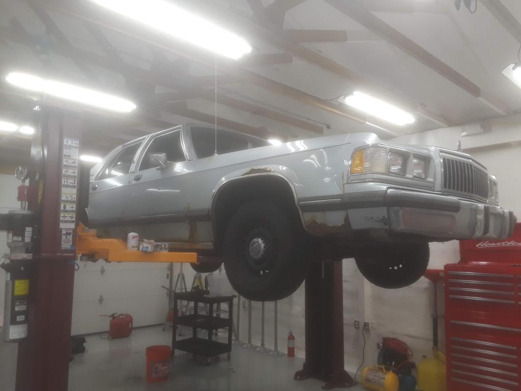

We got it, and The Ice Car is now home. Bit of a noob move I think is what happened. We ended up using some Permatex Motoseal, but think the problem may have been that we were lubing the gasket. Lube on the gasket allowed the gasket to squeeze past the face of the hanger, at least that's my theory.
It turns out I actually needed a new pump. It pumped just fine, but with the new pump the feed line holds way more pressure. So I guess there must be a check valve built into the pump? After running with the new pump we changed the fuel filter. Bled the line at the test port and have never seen that kind of pressure with the old pump. The line on the inlet of the old filter was also still pressurized. I've never seen that much pressure when I changed the filter before.
