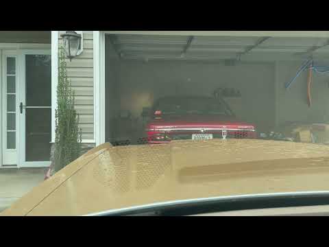

                While checking everything, I had the car running and got bored and cycled the turn signal switch and saw a good amount of light cast on the garage wall, and I was thinking, "Wow, this is some great turn signal lamp!", and then realized the headlights were flashing on and off.
                Seems something with the high beams were shorting with the left turn signal circuit. Similar symptoms were noted with the hazards. After fiddling with the switch lever for a few minutes, the issue corrected itself. I did go to the parts store and buy a replacement and swapped the switch assembly out anyway as not to chance a repeat issue. New switch feels good and the flash-to-pass activation area is considerably better than the old one, where you were always gonna pull it far enough to click to high beams to make them cycle.

                    That's certainly an interesting way for the turn signal switch to fail.

                        Nice . Yet another oddball radio!
                        I had to laugh at your video and your commentary. Just a weird one so it made me chuckle at the issue you were having.
                          I had the ignition switch seperate on my 87 a few years back. I was going to get a motorcraft unit but ultimately decided to go with a Duralast gold because the price and warranty. So far so good.

                              thats a really weird failure mode on the switch. Not impossible since the headlamp and turn signal circuits come together but very weird. I'd honestly expect damaged wiring to the switch more than the switch itself to have caused that.
                                The switch showed a fair amount of fine metallic shavings/bits on the forward face where the hi-beam action occurs. The switch was an original Ford unit, so there's a chance it was original to the car with all its miles.
                                Only place in town that had a replacement switch was Advance, so I wound up with whatever brand switch was in a CarQuest box. Had a lifetime warranty, so that was okay I guess. Engagements feel better than the old switch (occasionally it would make a very loud SNAP when engaging the turn switch). Flash-to-Pass occurs earlier too, as with the old switch I had to actually click the switch entirely to flash the lights.
                                Didn't have any trouble with the signals yesterday, so I guess that's a good thing.
