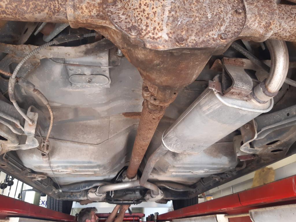

              Anyways, enjoy this underneath shot of my "rust-free" MGM:

                Nice underskirt photo. Ecoat is a wonderful thing, just look how clean those floor pans are as a result. By comparison, the rear end is scabbier a small child's knee. I've only seen one cleaner, and it lives in my garage.
