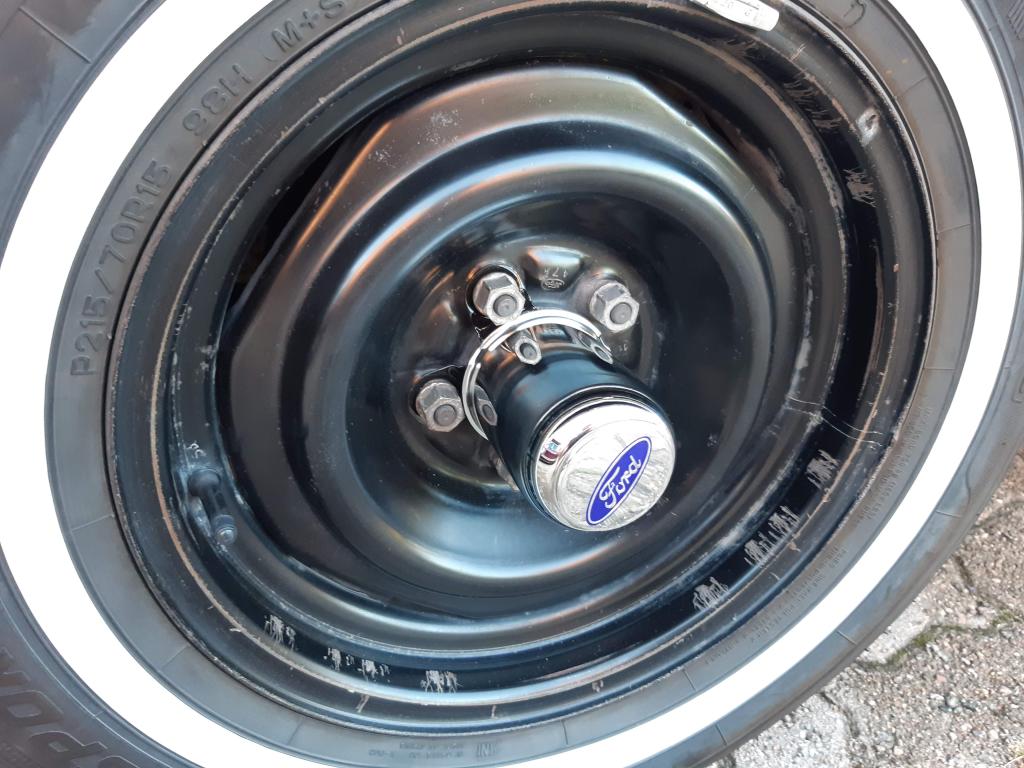

              I finally did something for the wheels. Dunno if I like it or hate it.
              It's just normal center caps slipped onto the original wire wheel cover lockbolt thingymabobbers.
              They're too long, but to make them any shorter would require cutting the "bracket" and the center caps, which I can't be arsed to do right now at all.
              2005 Volvo V70 Bi-Fuel
                And I think the later wire wheel brackets are too short to clear the front hub unless you do the medium or big brake swap.
                It does have a lot of poke, but so does that front hub, so meh. Looks better than bare.
                  You could always use Ranger or mercury mountaineer center caps with the correct lug nuts. P71 center caps (pancake style) won't clear the front hubs.

                      I'll have to feel around more. Those Ranger caps on GM_guy's first pic don't look half bad, whatever that middle pic is weird...
                      Mountaineer caps don't look too bad, even though I'm not a big fan of the flying M logo.
                      One problem with those are my spacers, they are m12x1,5 so finding correct lugnuts might prove inconvenient. Unless I bash out the m12 studs and put in new 1/2" studs, which is a pain in the ass. The current studs also stick a lot through the lugnuts.
                      Would these work? https://www.nippelit.fi/1st/html/def...tmode=showprod
                      The same store also sells the Ranger caps, 20€ a pop. https://www.nippelit.fi/1st/html/def...tmode=showprod
                        Not a fan myself. I like the look of just the dustcap over the rotor. I like GM-guy's idea if you must have a cover over the dustcap.
                          Oh, the flying M wasn't used on the pre-'88 models was it? In that case it wouldn't make sense to go out of your way to get a set of Mountaineer caps since the logo wouldn't match anything on the car. The explorer caps GM_Guy posted would be more appropriate then. Same lugnuts for the Explorer caps if I'm not mistaken.
                          The lug nuts in the link might not work, I think the ridge/shoulder thing is too far down and possibly not wide enough so the "fingers" on the backside of the caps may not grab. The lug nuts I have in the correct style currently don't reside where I do, otherwise I would go out and grab some measurements. Specifically how far up that collar is and how wide the collar is. I suppose you could order just lug nut and see if it works with the explorer caps. If it does, you'll need 3 per wheel.

                            If my car was a Ford, I'd probably be fine rockin' bare steelies, but on an MGM they feel slightly out of place. I have the best solution in the form of dog dish poverty caps, but I can't attach them to my wheels!
                            The more I fuck around with center caps, the closer I get to what I'd spend getting another set of steelies with the proper dog dish nubs.
                            I might shorten the current ones, assuming they stay attached. I've got about 900km coming up this weekend.
                              Well, I rather like the look of those black steelies you've got going. Great contrast against the white. Dog dishes would look cool too.
                                Yeah, but even so, the steelies require some attention to look even somewhat representable. They're super scratched from the full wheel covers, dirty beyond simple cleaning and the black factory powdercoat is immensely faded.
                                For the work that these wheels "require", paying some bucks for better condition wheels wouldn't hurt much. Plus I'd get the dog dish nubs aswell.
                                For the dog dishes, I've got a set of good condition 1962 Ranch Wagon poverty caps, which would look freaking killer on this car. Dad has a set of Thunderbird steelies which have the dog dish nubs, but the centerbore is too small and they have new tires mounted, which would cost many moneys.
