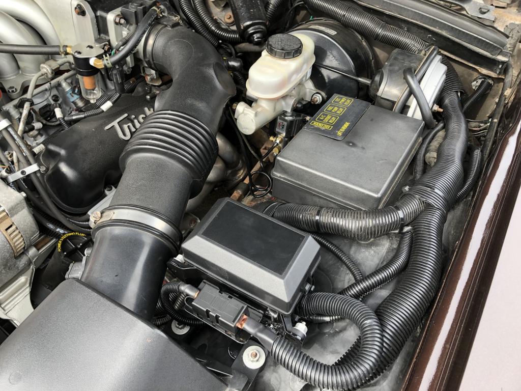

Engine:
- New LMR 5.0 302 V8 (SEFI) with Forged Pistons (LRS-6009EF)
- HO Conversion with A9P
- Tuned by Willie at Dirty Dog Racing with a Moates Quarterhorse
- Mass Air Conversion using 2008 Crown Victoria 80mm Slot Style MAF
- Trick Flow 170 Twisted Wedge Cylinder Heads (TFS-51410004-M61)
- NGK FR5 Spark Plugs gapped at 37
- ARP Cylinder Head Bolts (ARP-154-3601)
- Trick Flow Push Rods (TFS-21406700)
- Trick Flow Stage 1 Camshaft (TFS-51403001)
- Trick Flow 1.6 Roller Rockers (TFS-51400510)
- Trick Flow Double Roller Timing Chain (TFS-51478520)
- Ford Racing Roller Lifters (M-6500-R302)
- Ford Racing Harmonic Balancer (FMS-M-6316-M50)
- ASP Racing Aluminum Underdrive Crank Pulley (ASP928900)
- 24LB Denso Blue Top Fuel Injectors
- TMoss Ported GT 40 Lower Intake
- Lightning GT 40 Tubular Intake
- Custom Powder Coated GT 40 "Ford Racing" Tubular Intake Plaque
- Lightning EGR Spacer
- Lightning 65mm Throttle Body
- Trick Flow 3/8” Phenolic Intake Spacer (TFS-51520017)
- Trick Flow Valve Covers (TFS-51411801)
- Trick Flow Oil Fill Neck (TFS-51400800)
- SVE High Torque Mini Starter (LRS-11002B)
- ICT Billet EGR Delete Plate (551604)
- TAB, TAD, EGR and Smog Delete
- McCully racing Motors TFI (Thick Film Ignition) Relocation Kit (Mounted on Core Support)
- ARP Oil Pump Drive Shaft (154-7904)
- NOS Ford Metal/Rubber Valve Cover Gaskets
- 1990 Ford LTD Crown Victoria Drivers Side Inner Fender with Plastic Vacuum Reservoir/Relay Combo
- 2006 Ford Crown Victoria Police Interceptor Air Intake Box
- 2006 Ford Crown Victoria Police Interceptor Zip Tube
- K&N High Performance Air Filter (33-2272)
- Ford Racing 9mm High Performance Spark Plug Wire Set (M-12259-M301)
- Spark Plug Wire Separators
- MSD V8 Cap and Rotor Kit (8482)
- New Motorcraft IAC and Coil
- Billet Specialties Ball Milled Wire Loom Holder (69520)
- New Duralast Engine Coolant Temperature Sensor (SU201)
- New Motorcraft Fuel Filter
- New Duralast Alternator Belt (505K6)
- New REM Reproduction UnderHood Hood Liner (FM-753)
- New DEA Engine Mounts (A2437, A2438)
- Walbro 190 lph Fuel Pump
- 1985 Ford LTD Crown Victoria 351 Oil Cooler Set up with replacement Derale 15405 Cooler
- Moroso Oil Seperator Kit for PCV System (85481)
- Moroso Oil Seperator Kit for Valve Cover Breather Tube (85632)

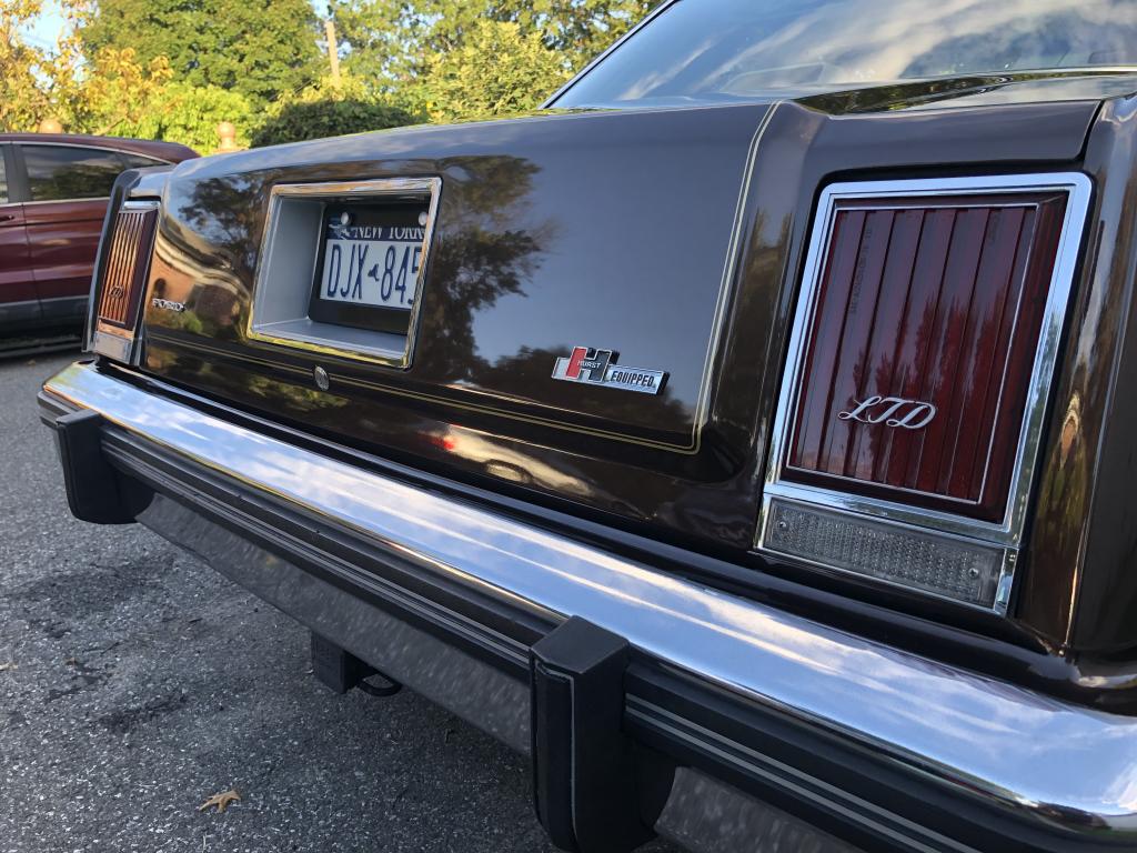

Exterior:
- Brand New Vinyl Top
- ProStripe Bright Gold Pinstripping (R320106)
- Scott Drake 68-69 Torino Ford Letters on Trunk Lid (67HD)
- Hurst Equipped Emblem on Trunk Lid (HUR-136100)
- Body Side Molding Delete
- Trunk Molding Delete
- 1979 Ford LTD Landau Sill Plate Moldings
- New 1963 Ford Galaxie LTD Sill Plate Emblems (C5ZZ-6513208-E)
- 1979 Specific Ford LTD Crown Victoria Chrome Rear License Plate Bucket
- 1981 Ford LTD Crown Victoria Grille
