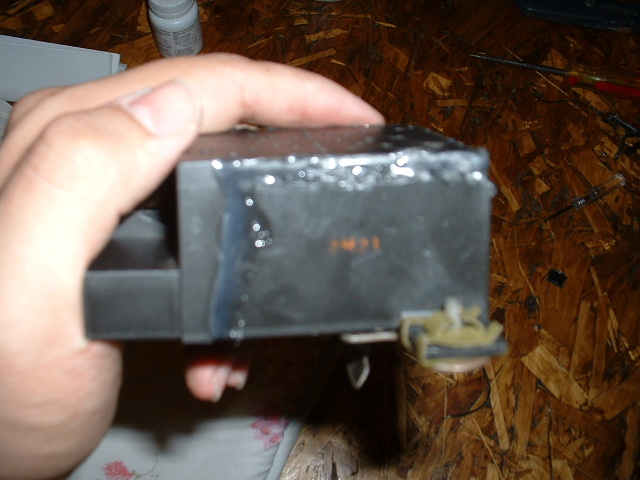

    The chime. On the TC, it is mounted under the dash on the left side by the floor vent for the heater. It comes out with one screw on the lip under the dash. You can see I removed the mount for the chime as well, which mounts to two clips on the back.

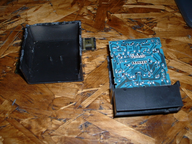

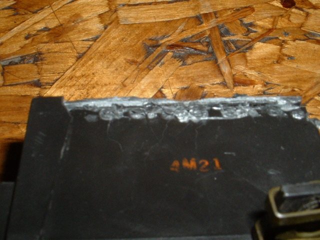

    The two parts of the shell is glued together. The way I handled it was I took a pair of plyers and broke the lip off, then used a screwdriver around the seam. You'll know it's coming apart when the glue cracks.

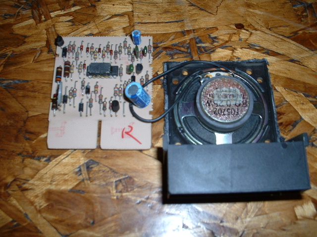

    The shell opened, PCB exposed.

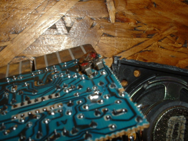

    The other side. The speaker is just a standard cheapo 8 Ohm .25watt speaker. You can see the wires passing behind the large Capacitor on the right. This is where we make our mod.

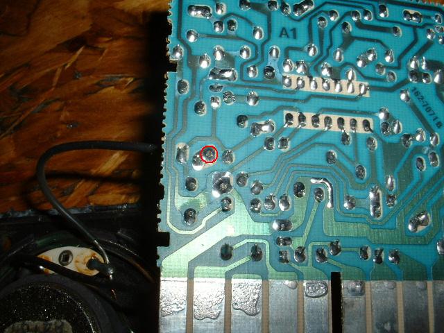

    The red circle shows what joint to desolder.This is to the + side of the speaker. Desolder this peice of wire from the PCB, and then unsolder it from the leg on the speaker itself.

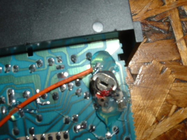

    Solder the piece of wire to the front leg of the varistor (trim wire to length). Solder the other end to where the origional peice of wire was on the speaker.
    Hot glue the exposed legs to keep them from shorting other componants when you put the shell back together.

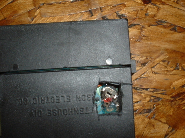

    Cut a hole in the shell (hopefully less shitty than the one I made lol) so you can adjust the varistor once the cover is reinstalled.

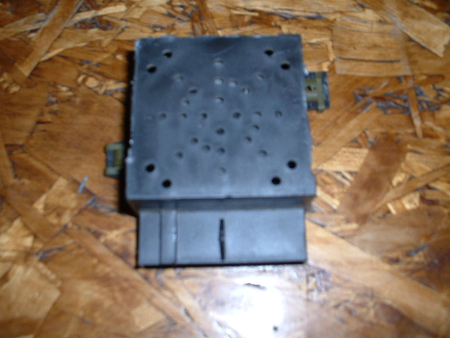

    Hot glue the shell back together.
    Plug the chime back into the harness, reconnect the battery. Turn the varistor until the chime is at it's loudest, then turn it back to where you like it. Or, you could just turn it all the way to it's off. Replace the chime under the dash, and enjoy a less annoying door chime!
