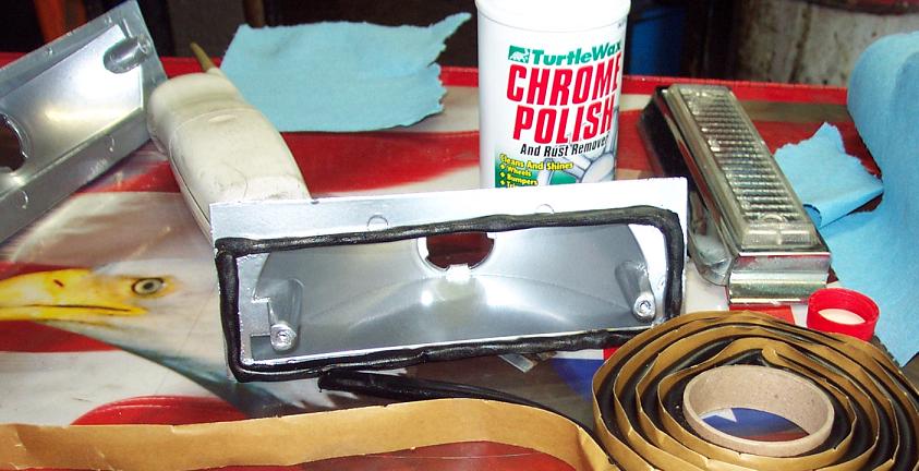

how can i make my reverse lights brighter and turn signals
look inside your backup and turn signal lenses... most likely the reflective material is deteriorated.
The backup lights only have a shiney paint coating on them, I was able to replicate this with mexichrome spray paint.
The front lenses actually have a mirror like coating on them that would cant reproduce. New lenses with this coating in good shape will help too.
