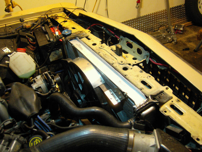

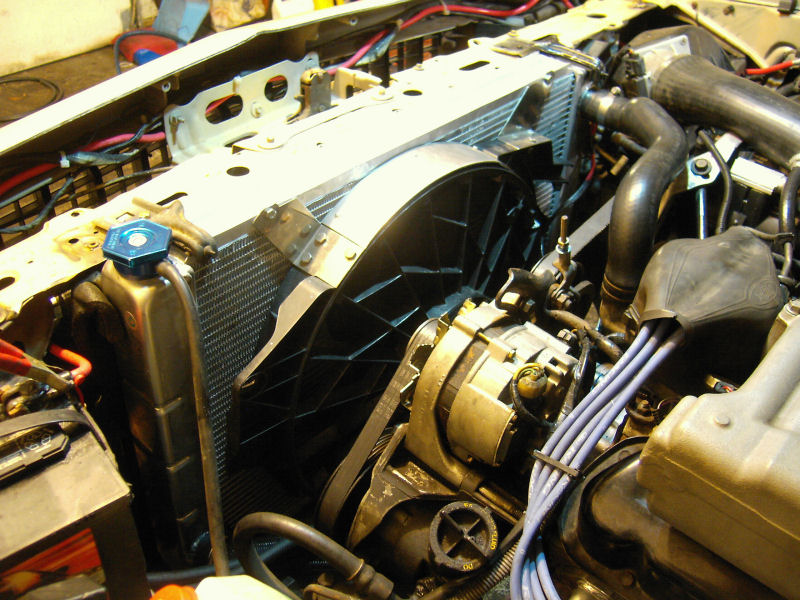

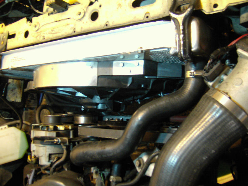

          Here is my e-fan upgrade. I already had a temp sensor/relay system installed since I had an electric fan already, but the 05 Mustang fan fit much better, and cools a whole hell of a lot better.
          http://www.grandmarq.net/vb/showthre...hlight=Mustang
          Here is a pic after the radiator upgrade as well. Put it about as close as you can go without hitting the pulleys.
