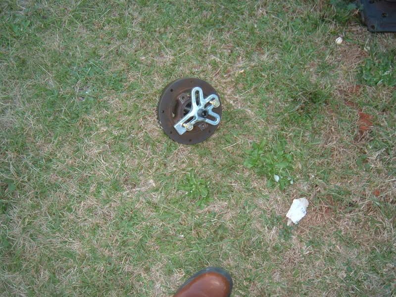

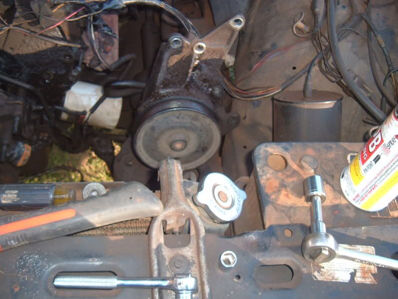

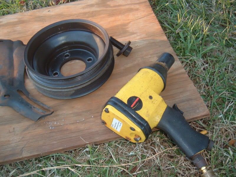

    You can probably fit your impact on that bolt once the crank pulley is off. Though if it's being as stubborn as you say, I'd heat it a little and soak it some more and try with the ratchet again.

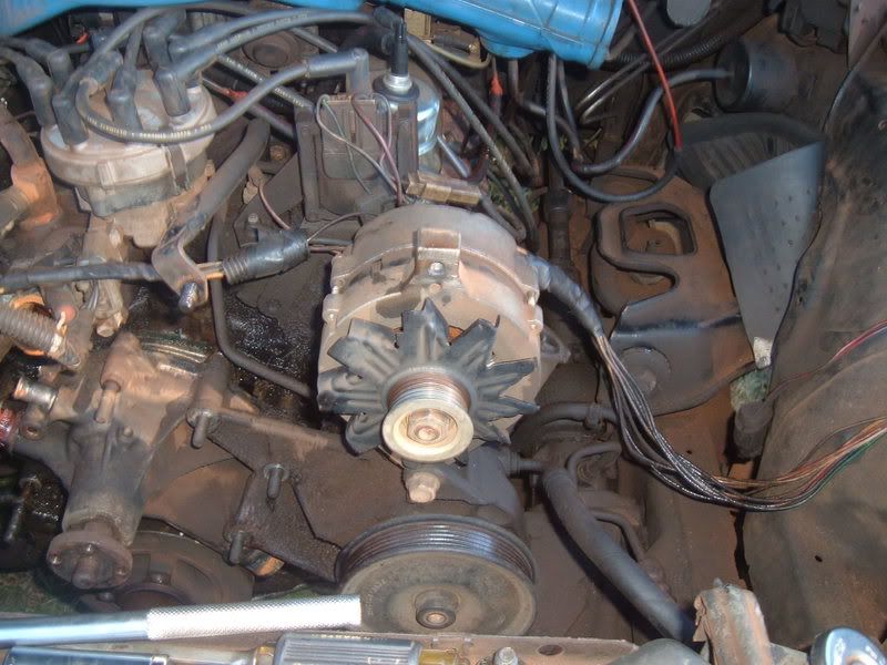

    The huge aluminum piece the bottom of the alternator mounts to is the power steering pump bracket; yeah, that's gotta come off.
      Ok, so best bet is dosconect alt. then just start taking nuts and bolts off. : Nods Allrighty mang
        yup!

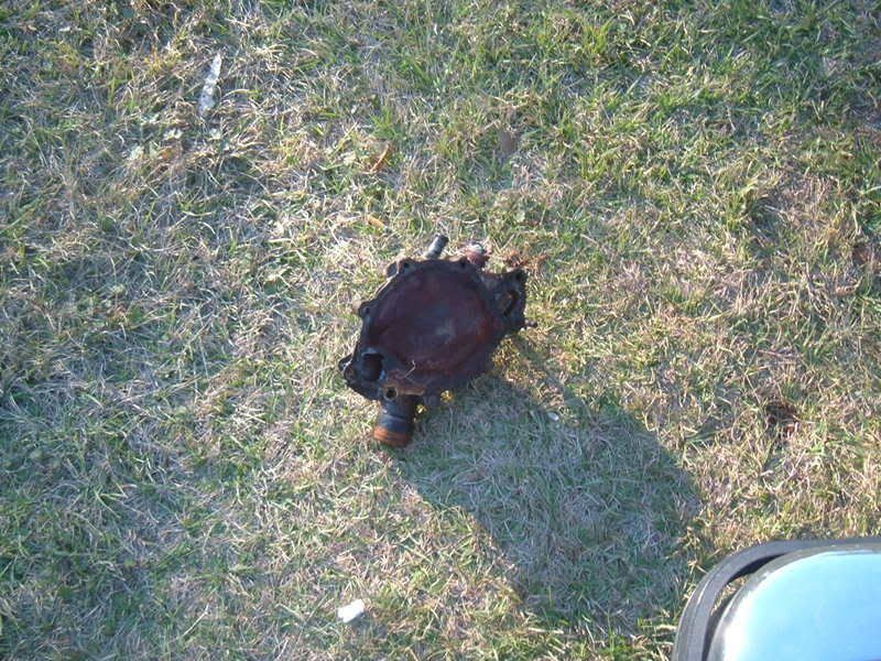

          Well I FINALY got the water pump off! woot.

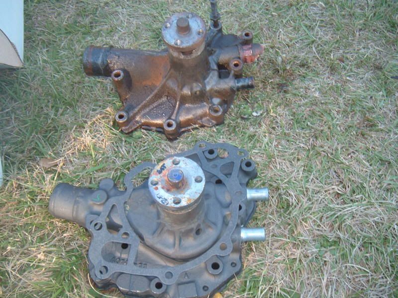

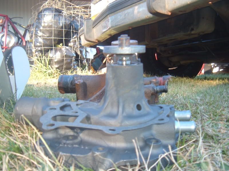

          But i finaly also looked at my new water pump and see the words, referbished on them, right after i took note that i saw no new bolts
          Im mad at myself for not seeing this earlier. and mad at them as well, for even selling auto. a refurbished water pump...

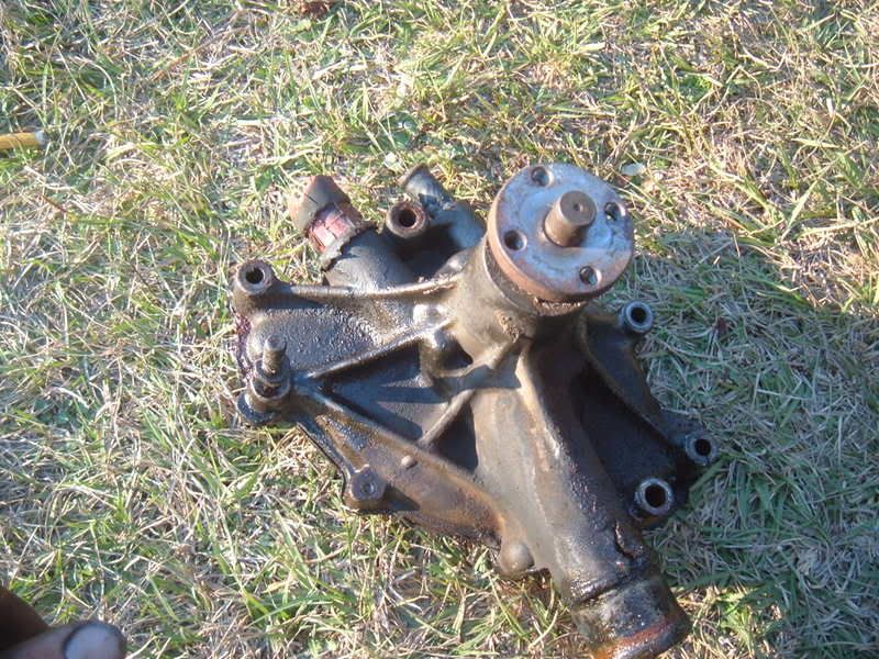

          Anyways.. can i use this mang's? It looks exactly the same imo as mine. but i dunno
          If i can use it i just will, if i cant then im going to half to find some way of taking it back and getting a actual new one..

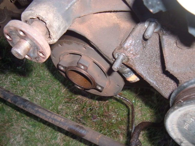

          The bolts actually dont look all to bad. that one still hase=nt poped out but i got it untreaded :P, and ima hit it with a hammer in a min to get it all the way out.

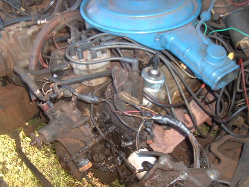

            I wound up just moving the power stering and alt brackets.

              Nothing wrong with refurbished water pumps. The main parts to go bad are the bearings and seals, and those are replaced when they're rebuilt. It's just that the body, shaft, and sometimes the impeller have been used before, but those parts won't be reused if they're not in good condition. FYI, I once got a new water pump where the back was a little warped and you could see gaps next to the gasket, so I pulled the back off and flattened it a little and reinstalled it with a little RTV to make sure the gasket sealed. New bolts aren't normally provided; if one breaks, you may be able to get a replacement from Ford, or check with our pal Lincolnmania.
              The heavy-duty iron unit is what I've always had on my '87 engine; it interchanges with your aluminum one except for the heater hose outlet (the bigger of the two small ones on your old one) and one of the water pump bolts being either shorter or longer. There's also an extra bolt hole in the middle that you can use if there's a place for it in your front cover; but it'll be fine without it. I'm pretty sure the perimeter bolt that's different isn't one of the funny studs that mount something else to the top of it, but double-check to make sure. If I'm right, you can just grab a correct-length new Grade 5 bolt from the hardware store and use that.

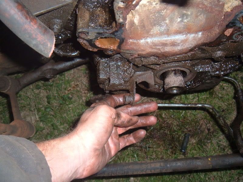

                Take a look at that bolt, and see if it dont look familure
                Now ounce i got that, that cover was a little pita. i tell you what. not hard to get the bolts of mind you. just eh, there kinda hard to find!

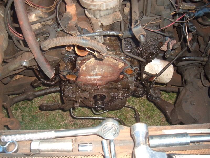

                One last nut annnnd
                there is a ton of slack on the drivers side of the chaina s well, along with that i see what apear to be cracks in the gears >_>??? biguns and littuns.
                So im guessing that indeed it was time for a new chain aye?
                The Harmonic balncer the ruber part, was missing chunks out of it , So agine im think that was wise to go Ahead and get a new one

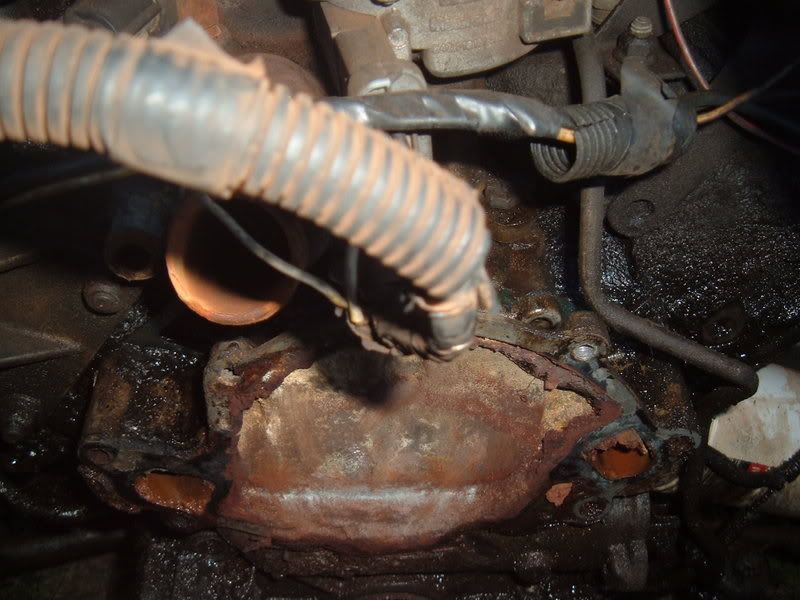

                  :-? And now where is this bloody t stat ?
