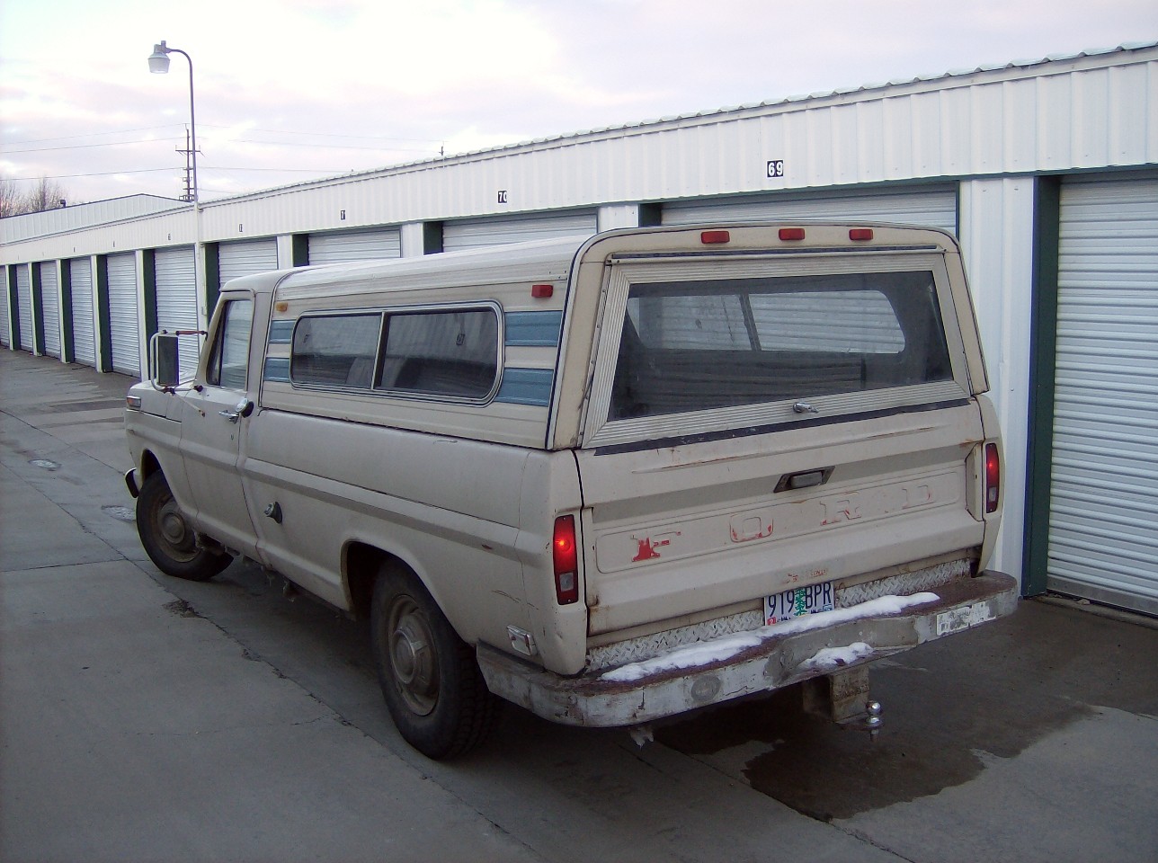

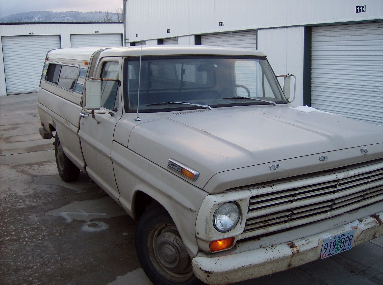

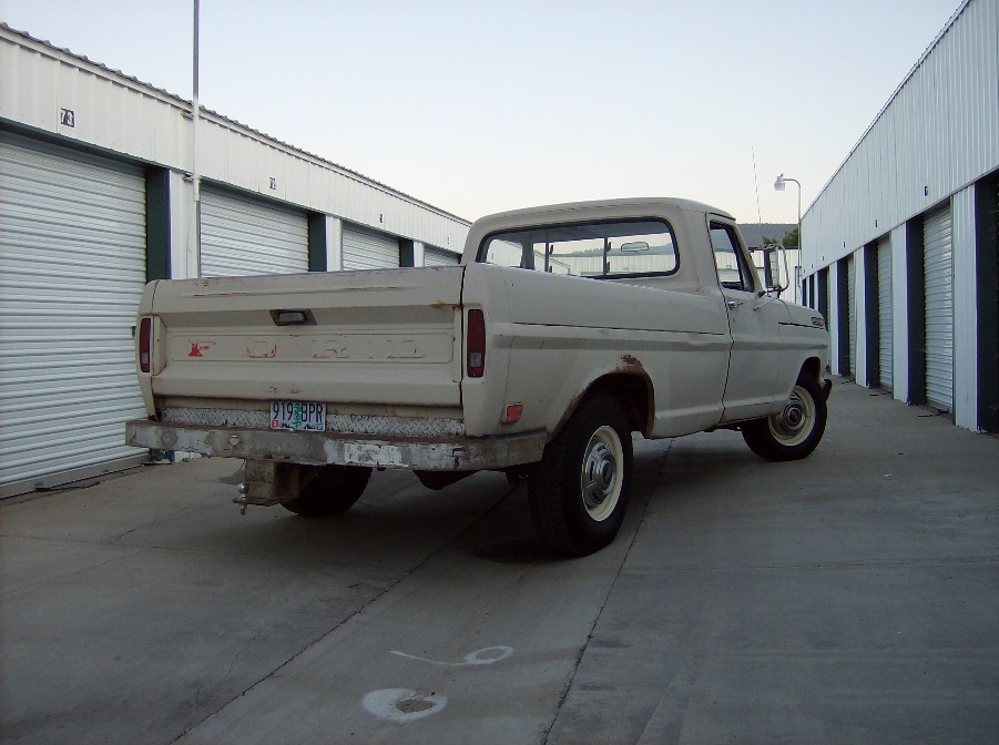

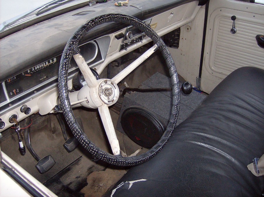

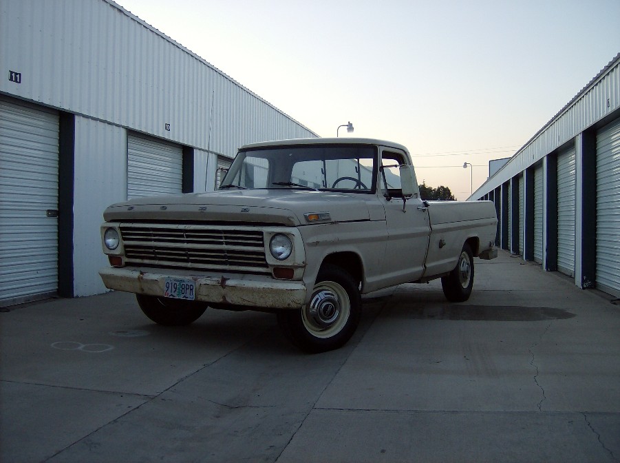

                      Can't remember when I bought the truck. I think it was either January or February. Hmm. Will have to investigate further. Anyway, the pics from when I first got the truck.

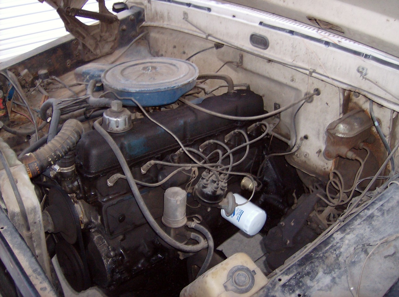

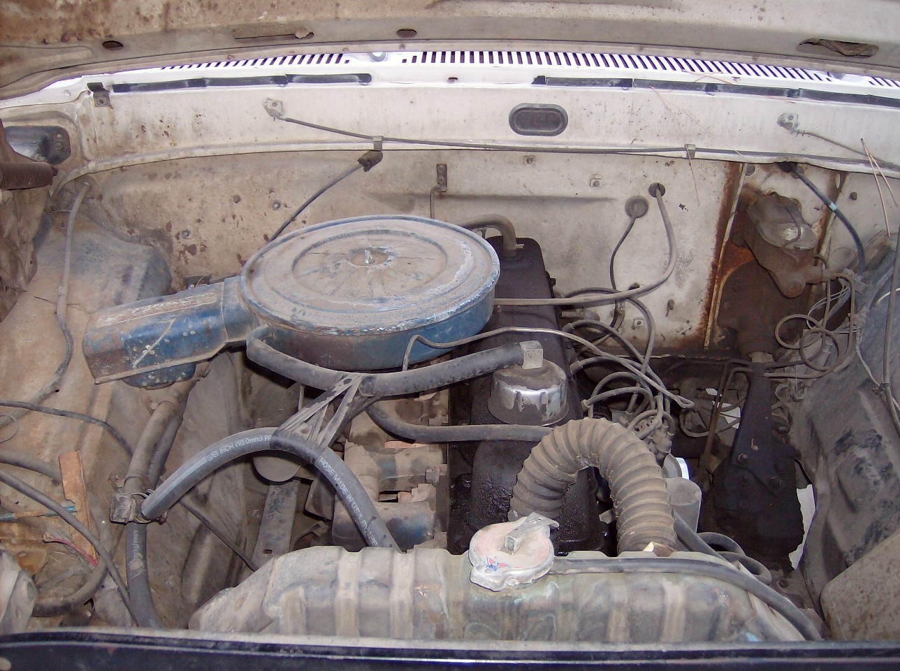

                          Got to get updated engine pics. And some vids.
                            MMMMmmm, simple, the way god intended. Id spray the bumpers silver and leave the rest alone, it adds character. My buddy shot his tailgate with a 12ga to add "character". He took it off first of course.

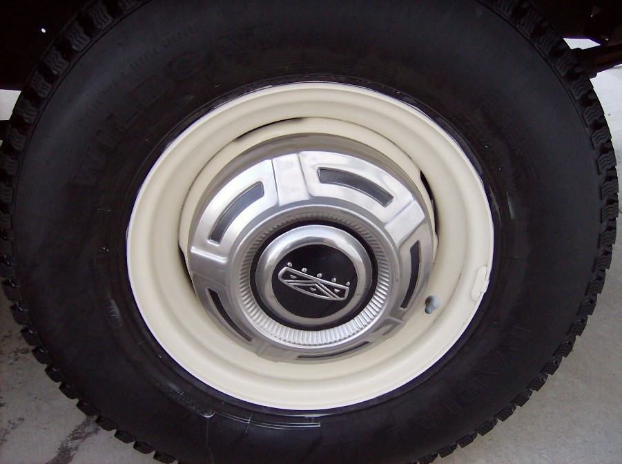

                              Nice, Jon. The only thing that could make it better would be 4WD, and really tready tires. The wheel/ tire combo.... MMM...MMMMMM...MMMMMMMMMMMMM
                                The name makes me laugh tho. This burley truck with the name pebbles lol..
