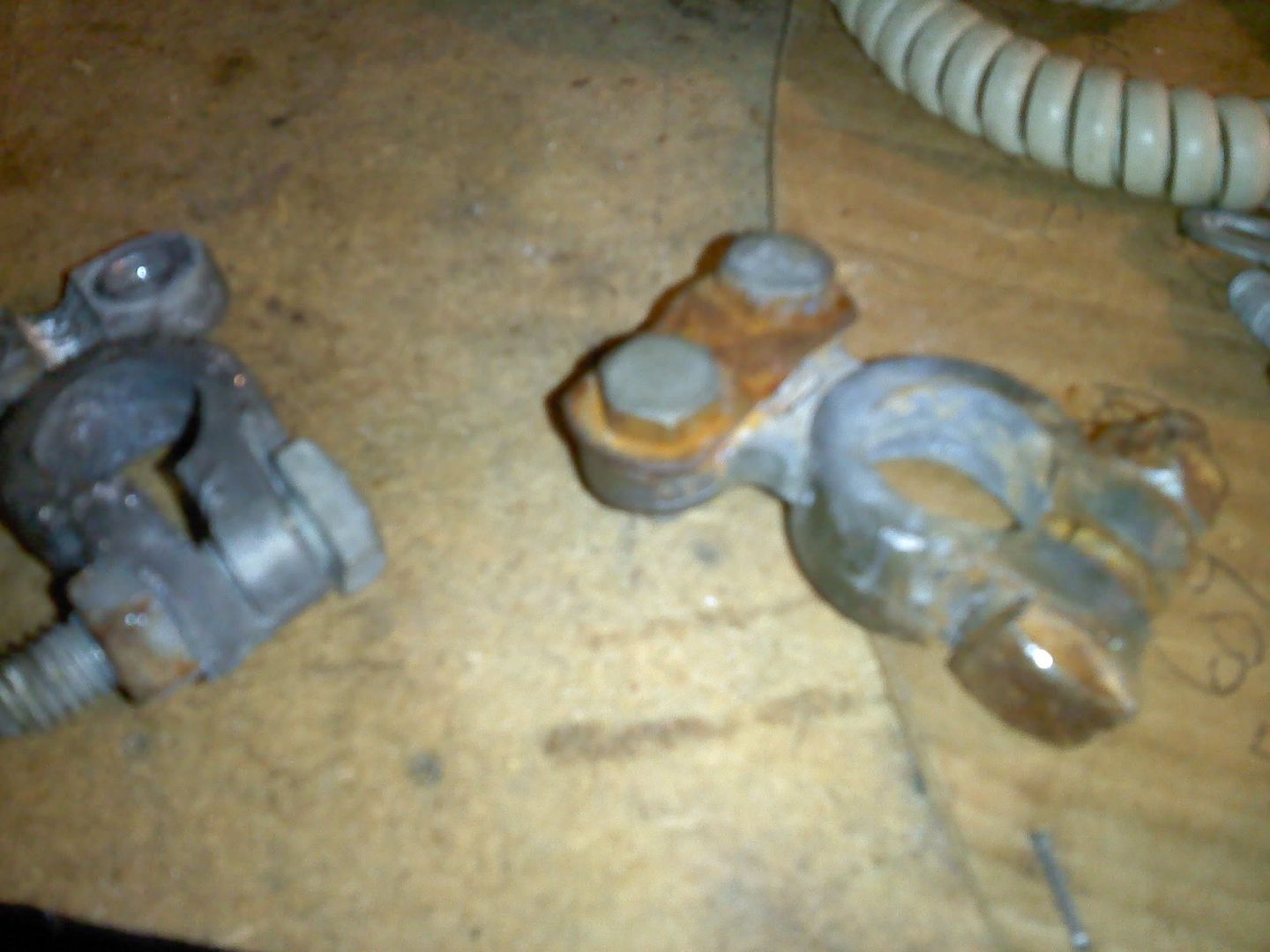

          Man, those terminals were SHOT. You can't see it, but there's a TON of pitting and cracking inside that is absolutely HORRIBLE for conductivity! New ones are in, but it was pitch black by the time all was said and done. Still, it was a relief once I got the car in the garage. Speaking of, here's the progress I made:

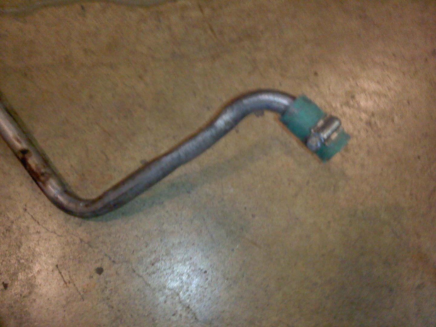

          What's that pipe with a piece of GARDEN HOSE attached to it!?
          Oh, yeah, it's MattsUselessSmogControlSystem - tossed it.

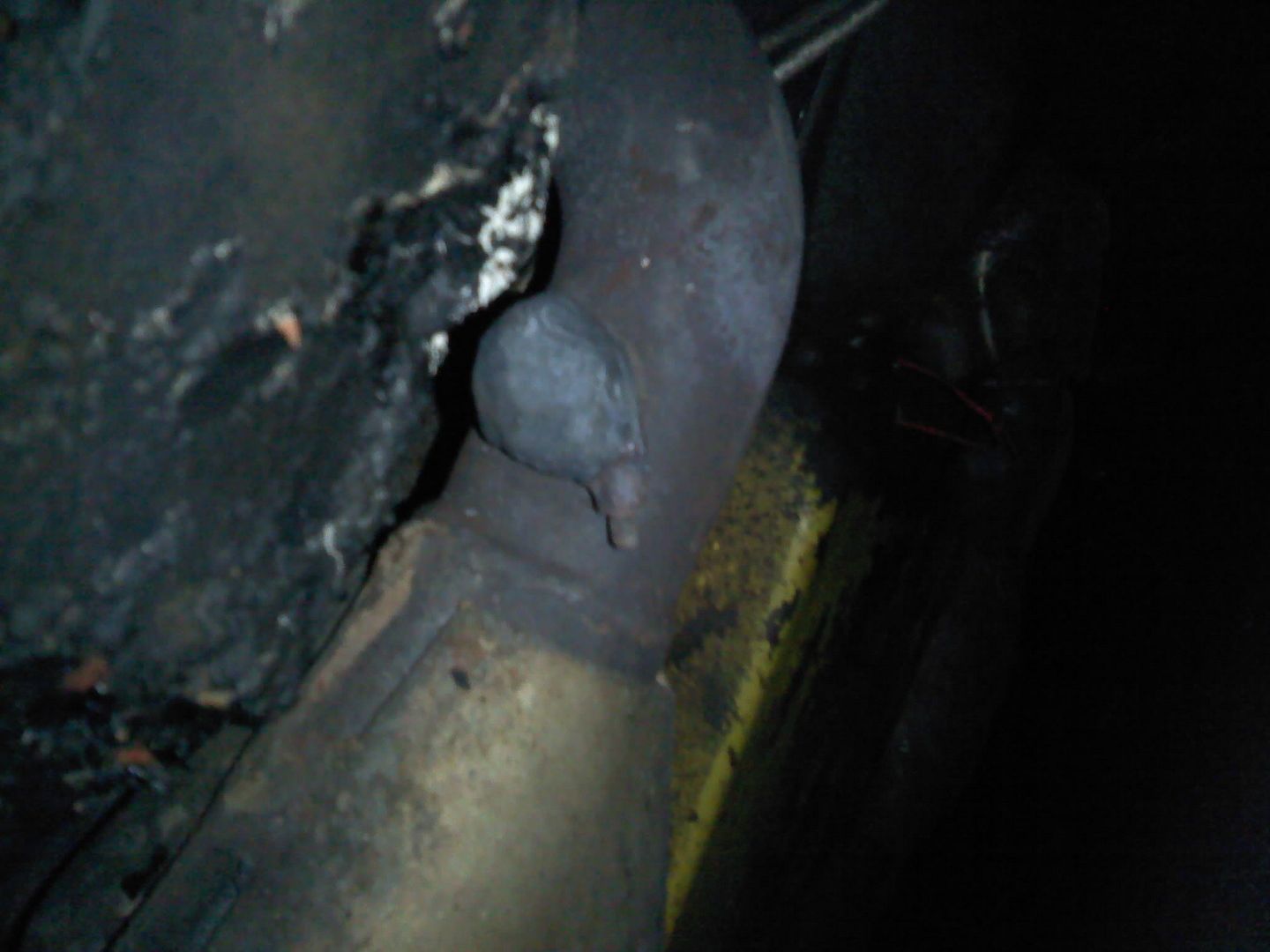

          Took a bolt slightly smaller than the hole, coated it in QuikSteel and shoved the bitch in there. Did a couple of 0-85 runs wearing gypsy tags, and all seemed fine.
          But it's like a domino effect with this car. Solving one problem leads to another. While the CATS don't leak any more, the FLANGES connecting the downpipe to the axle pipe have NO GASKET. So they leak like a bitch! I wonder how much of a pain it's going to be to remove those bolts... and what kind of universal exhaust flange gasket I could use for 2" piping. Hm... any suggestions?
