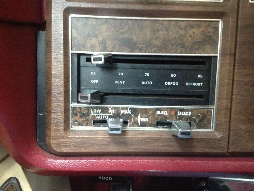

                I also have a question about the automatic climate control thing. When I moved the temperature dial up, the heater would come on. The system is out of refrigerant so the a/c didn't work. Now, when I move the switch up the heater won't come on, but the heater core is ok. When I move the switch to VENT, it blows air out the dash vents, and when i switch it to AUTO, it only blows air out the vents under the dash. What is wrong with it? How is it supposed to work?
                1989 Mercury Grand Marquis GS- "Sarah" 122k miles
                1975 Lincoln Continental Mark IV- 275k? miles
                  When you say, "under the dash" you are talking about the floor vents correct? If so I would think that is correct. Most (if not all) ATC systems direct heat to the floor and A/C to the panel vents.
                  When you put if on "defog" I believe you should get floor and defrost together. And obviously on defrost it should only blow out of the defroster vent.
                  I would think this system is highly dependent on the cabin temperature sensor. If it's wonky, the system will do all kinds of stupid stuff.

                    Iirc there's 8 million vacuum lines going into the back of that control unit.

                      Yeah that system is different than what my 79 had. They simplified it for 78/79 to something more like what the box Panthers had which is really "semi" ATC. You have to select where the air comes out.
                        Yep, that's exactly how it works. Except when I put it on auto and move the temperature switch up, it just blows cold air out the floor vents. Where is the cabin temperature sensor? I guess I need to look in those shop manuals I got.

                          That automatic climate control system is the same as the one in my '76 Thunderbird. It's quite an ingenious piece of electromechanical engineering. Works very well when everything is functioning. The system in my T-bird was flawless. If the system blows air on the floor when you move the temperature up but the air is cold, you have an issue with the temperature blend door (vacuum actuator), heater core or water valve (also a vacuum actuator) on the heater supply line. The "cabin temperature sensor" is actually a bimetallic switch behind the passenger dash panel with a cable from the temperature control on the dash that changes the tension on the bimetal strip. This accomplishes the automatic selection of hot or cool air based on your desired temp and the air temperature within the car. There's lots of potential for vacuum leak and electrical/mechanical failure in the system, but when functional it is quite an ingenious way of providing fully automatic HVAC control with no computer power whatsoever!
                                It sure is! You're right about the potential for failure, nine vacuum lines run to the back of the control unit. I'm betting that its that bimetallic strip, but I guess I'll have to have the dash apart to find out, I'll check the manual again. I hope someone still makes parts for the system.
