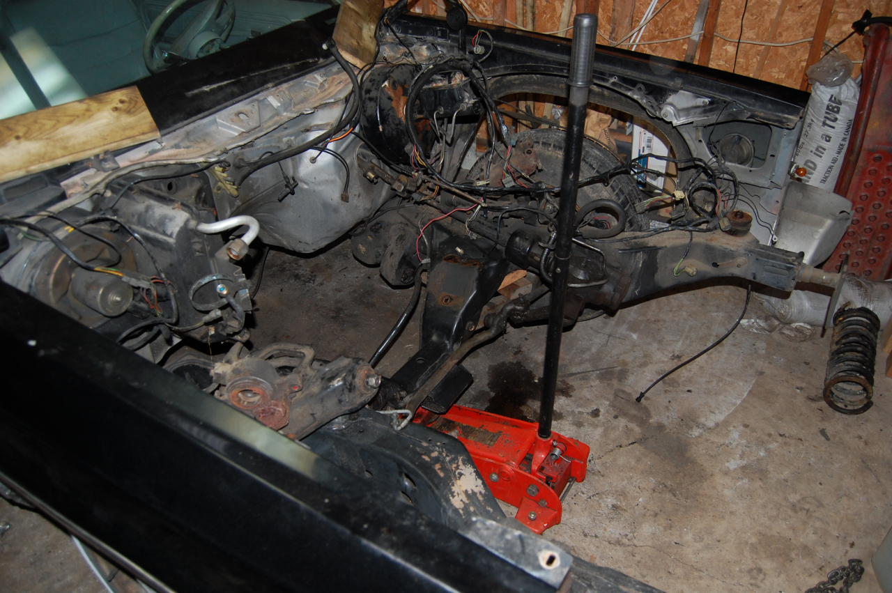

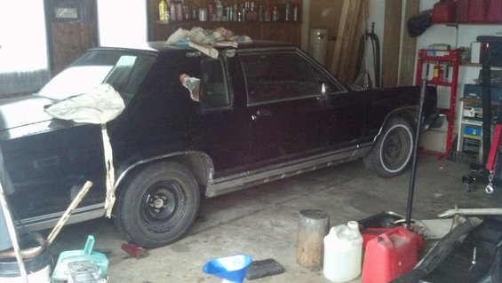

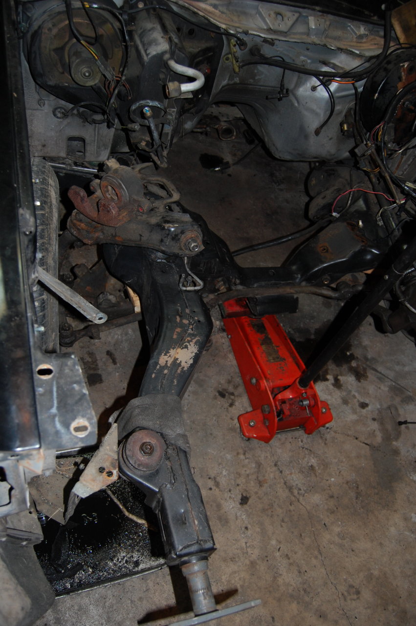

I am slowly making progress on the car (weather permitting).

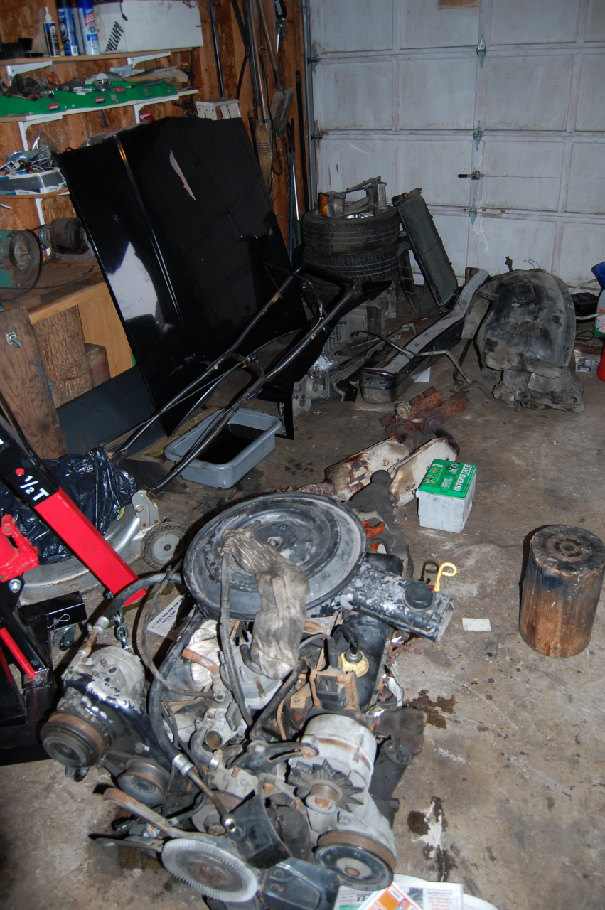

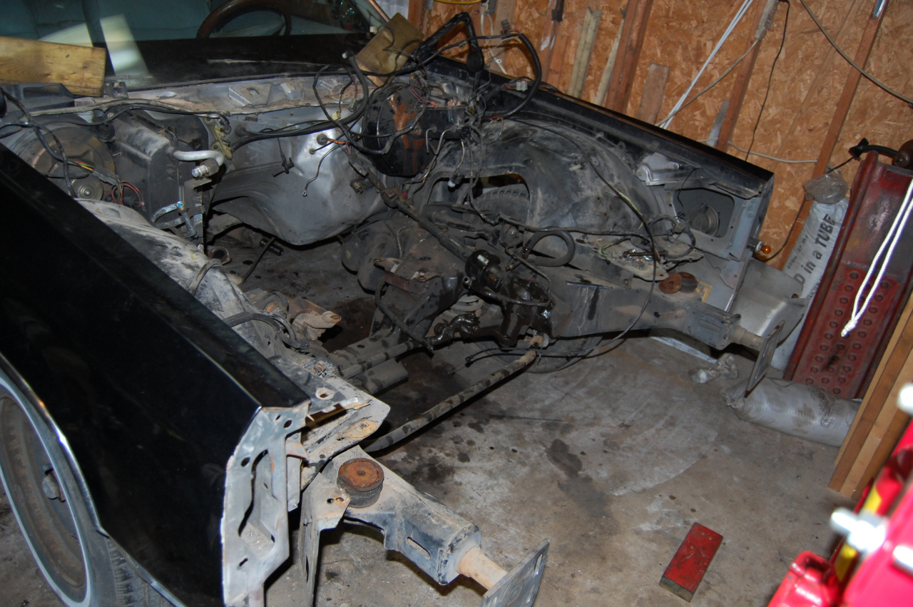

I took the nose off and yanked out the drivetrain. I figured it would be easier to pull them with entire nose removed which it was. Having virtually no rust on the car was a huge bonus as every singe bolt and nut came off without an issue.
302 mounts had to come off and thanks to Ford that meant taking apart the suspension so I can access the bolts. Suspension is getting replaced anyway so no loss there. I pulled plastic inner fenders while I was there too.
The springs are now gone and have been replaced by wooden blocks.
Also, I took the front bumper apart as it was hit on one side by previous owner and bumper reinforcement was slightly caved in. I managed to straighten it out with a help of a shop press. Gotta love having all the fancy tools for the job.
I really wish I had a welder...some day I hope.
I guess I am parking second car outside for a while.

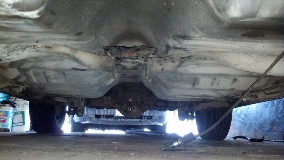

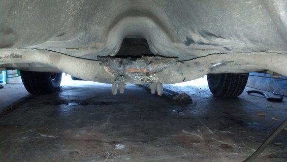

Looks like good progress. Looks like you lucked out on a solid car. Look forward to more pics!
Also, do you plan to keep the lower shiny trim? Do those pieces shine well?Last edited by marquisman; 12-18-2013, 10:40 PM.

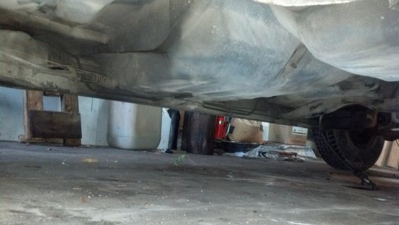

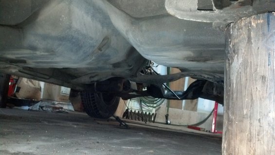

wow... that is amazingly rust free. Even more so than any of mine.

That thing is clean underneath. Repainting the top or the whole car?2020 F250 - 7.3 4x4 CCSB STX 3.55's - BAKFlip MX4
