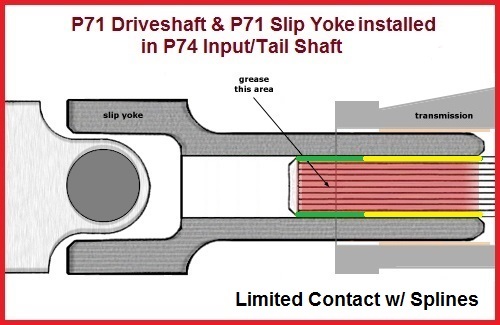

While the two of them were working on replacing the fuel tank on Grand1's '79 I attempted to swap the '08 (I think) P71 aluminum driveshaft. Side by side I couldn't see a reason why I needed the spacer that everything I have read said I would need. Derek was sure I didn't need it and after I got home and posted in the WAYWO thread Gadget's opinion was the same. The thing that stopped me from doing the swap is that I had ordered 1330 u-joints last year but it turns out that I need a 1330/1310 conversion u-joint to run the stock '98 slip yoke. So I slapped the stock driveshaft back in which I had marked the position with my paint pen before removing. Conversion u-joint is on its way, so I'll get this swap done eventually.

Thanks for the feedback, I'm a bit slow at times when it comes to understanding things.
I was able to take a look in the P71 slip yoke on Saturday and noticed that those splines start much further down/in than the fully splined stock slip yoke. Even though the stock slip yoke is shorter, the stock slip yoke has much more splined area.
So that makes sense that I would need the spacer with the P71 slip yoke (for the splines to reach/better engage the shorter non-P71 output shaft).
But if I swap the stock slip yoke onto the P71 driveshaft, it seems to me (Derek and Gadget as well) that I would not need the spacer since both driveshafts are the same length (or very close to the same, certainly not 3/4" different) center of u-join to center of u-joint. With the stock '98 MGM slip yoke and P71 driveshaft there would be negligible difference (if any) compared to the stock shaft with stock slip yoke. Or am I not understanding something correctly?Last edited by VicCrownVic; 06-01-2021, 12:18 AM.Vic

Everything I've researched recommends using a spacer. You will get more engagement using the regular yoke but you don't have the long tail shaft which also helps support the the longer p71 yoke.
I'm using a F150 yoke that fully splined with a spacer.1997 Grand Marquis LS HPP
