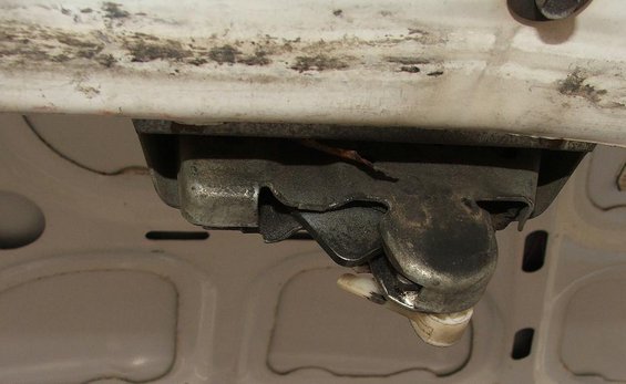

well not only does that part not reach, but i had the thing spaced out with washers and it looked like the smaller surface area of the washer holding the e thing to to trunk lid would make it weak.
I dont know if the funny angles would tweak it some way that might cause damage...

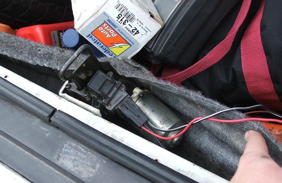

BUT there is still hope... I was in a random junkyard a few weeks ago and noticed a 90's Continental that had a power trunk pull with the rear edge of the catch extended out like a "P" shape.... it may be what I need. They wanted 20 bucks for it so I passed - I can do better than that.
I grabbed one of those early 90's continental parts and sure enough the thing is extended out just how I need it to be. Wether or not it is enough to make it work, we shall see.
What I have done is taken apart both pull down motors and swapped the striker catch/gear out of the continental one and into the towncar one.
The whole continental motor looked like it would have worked as it is, but this particular one had a bad motor, and the wiring of the connector is a little different.
Stay tuned for the test latch. it will decide the fate of this project!!!!

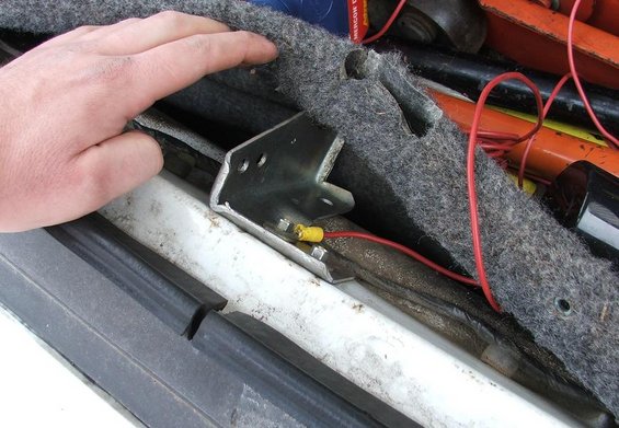

The TC actually has a plastic cover for it. The trunk carpet just has a hole cut out for the plastic cover. Could probably do the same with your CV trunk carpet.
