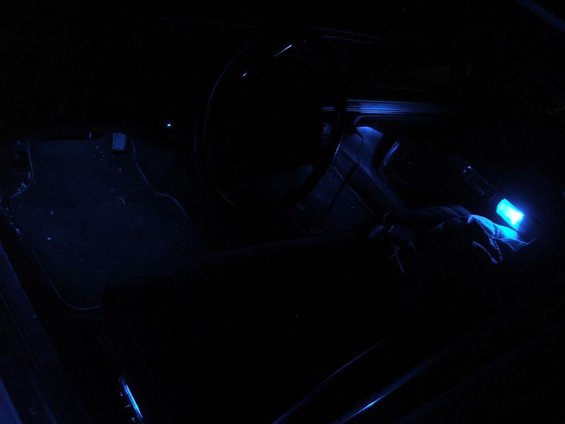

this is the 91 with the 5-LED 194 bulb replacmenets in the doors and stock courtesey light fixtures. The camera doesnt pick up the floors too good but its a nice filling ambient glow. If you wanted it really bright, you could put 906 type bulb 9-LED replacements in there tooI havent bought any of those yet...

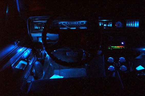

this is a good pic I got of the 85 with the old digicam... everything you see is 194 bulb replacement, except the aftermarket gauges (5mm LEDs) and the HVAC control (still incandescent in this pic)
