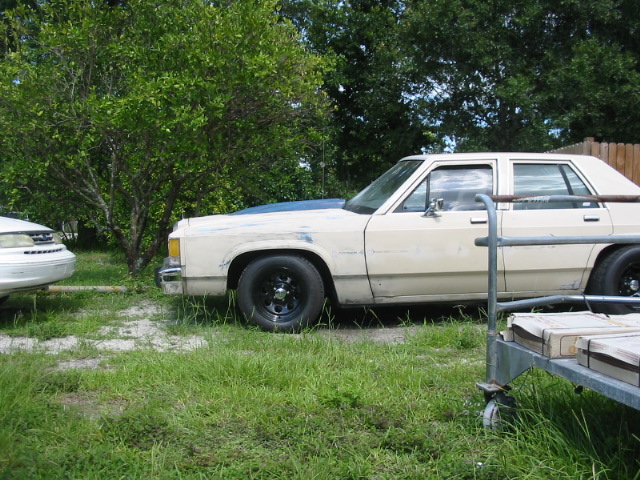

I installed the cowl scoop today. I now have a 2.5" blue cowl on my hood. Pics later, camera batteries went dead right as i took the picture
My car is ugly again.

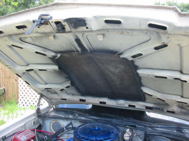

Underside shot. the big dark area is the underside of the scoop.
The scoop is fiberglass. the black stuff you see is 3M Panel Bonding Adhesive. Right now there is about 10 rivets holding the hood on since the adhesive takes 24 hours to cure and i had to drive it home. The rivets will be drilled out and the scoop will be blended into the hood.
