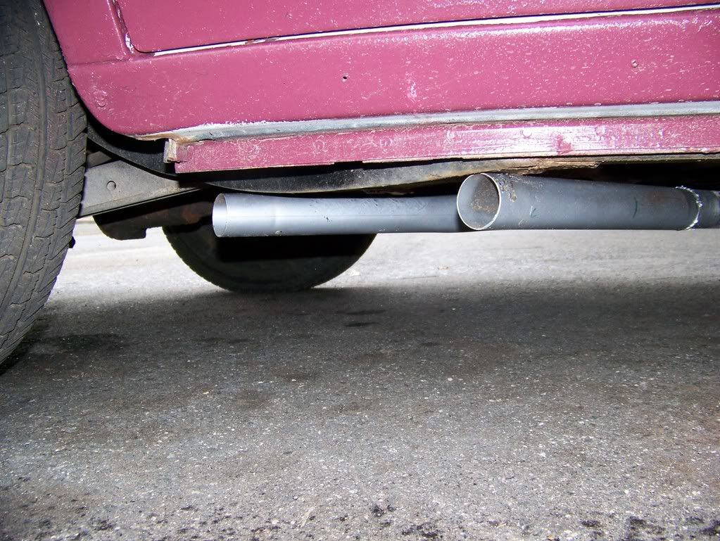

                                I was hoping I could find a better picture of the pipes I made for the burnout box.
                                This was all I could find (the outlets, in front of the passenger's side rear wheel)....
                                My intent was to make the exhaust blow the tire smoke outward, and it worked ok...
                                I used a sectioned '04 P71 h pipe, and some misc bends and shit pipe I had laying around. I buzzed it all together with a shitty welder, and put it on.
                                The results... This is what a stock LO 5.0 sounds like with converters, but no mufflers. Still pretty quiet.
